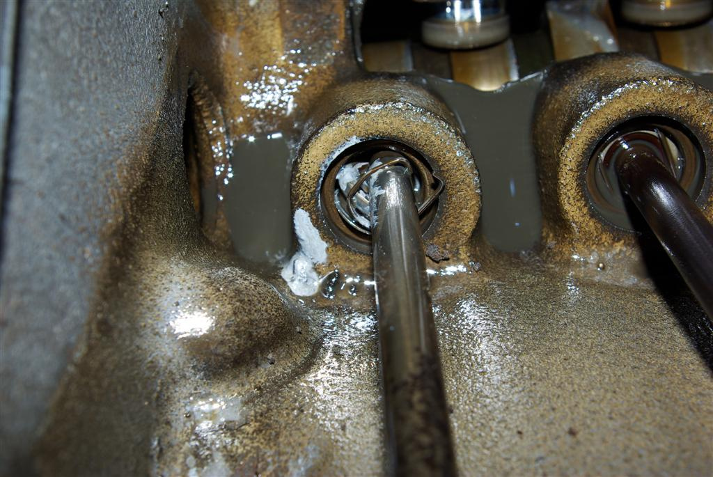

Re: Engine idles rough in "Drive" but fine in neutral or par
...... so check this out! It ran OK but with no miss it was really ugly inside!
- 6057499120_d72a26c12b_b.jpg (244.12 KiB) Viewed 15127 times
- xgecko
- Posts: 454
- TOA Membership Number: 831
I have to ask... what is the story behind this?
