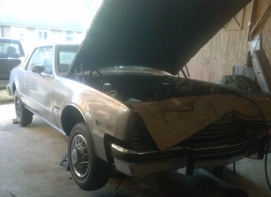

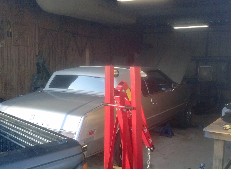

Post some pictures of the car. My rich uncle had one of those when I was a kid. It was the coolest car anybody in the family had. His wife, my Aunt, had a Dodge Dart Swinger - green with the bumble bee stripe. They were cool, hip couple at family holidays - at least with us car-loving cousins!

Thank you guys very much.
I got a hold of someone from opgi, and they said the manifolds they make won't work. Whether that's completely true or not, you guys are right, $450 is a bit steep to find out for certain (even though they'd probably refund if they didn't). I'm going to discuss it with my grandfather, and he might go either way, but it does sound like used is the better choice.
I am going to try to post a shot or two of the car now. I don't have any glorious shots yet, only working ones, but I'll see if I can keep an update on the project. Internet connection out here is terrible (I'm porting 2g from my cell phone to my laptop to accomplish this post), as my grandparents live on a ranch in an underdeveloped part of South Texas, but, c'est la vie.
Again, thank you for the responses.
