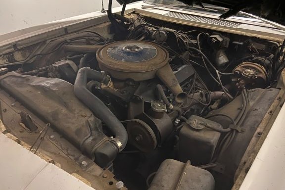

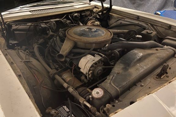

I had success in opening the hood for the first time. I am very happy to see that I have an untouched engine compartment. On the the hunt for a hood release T-handle replacement.
Anymore tips on where to look?

Engine bay looks good and complete. Always nice to know that nobody's been monkeying with stuff under there.

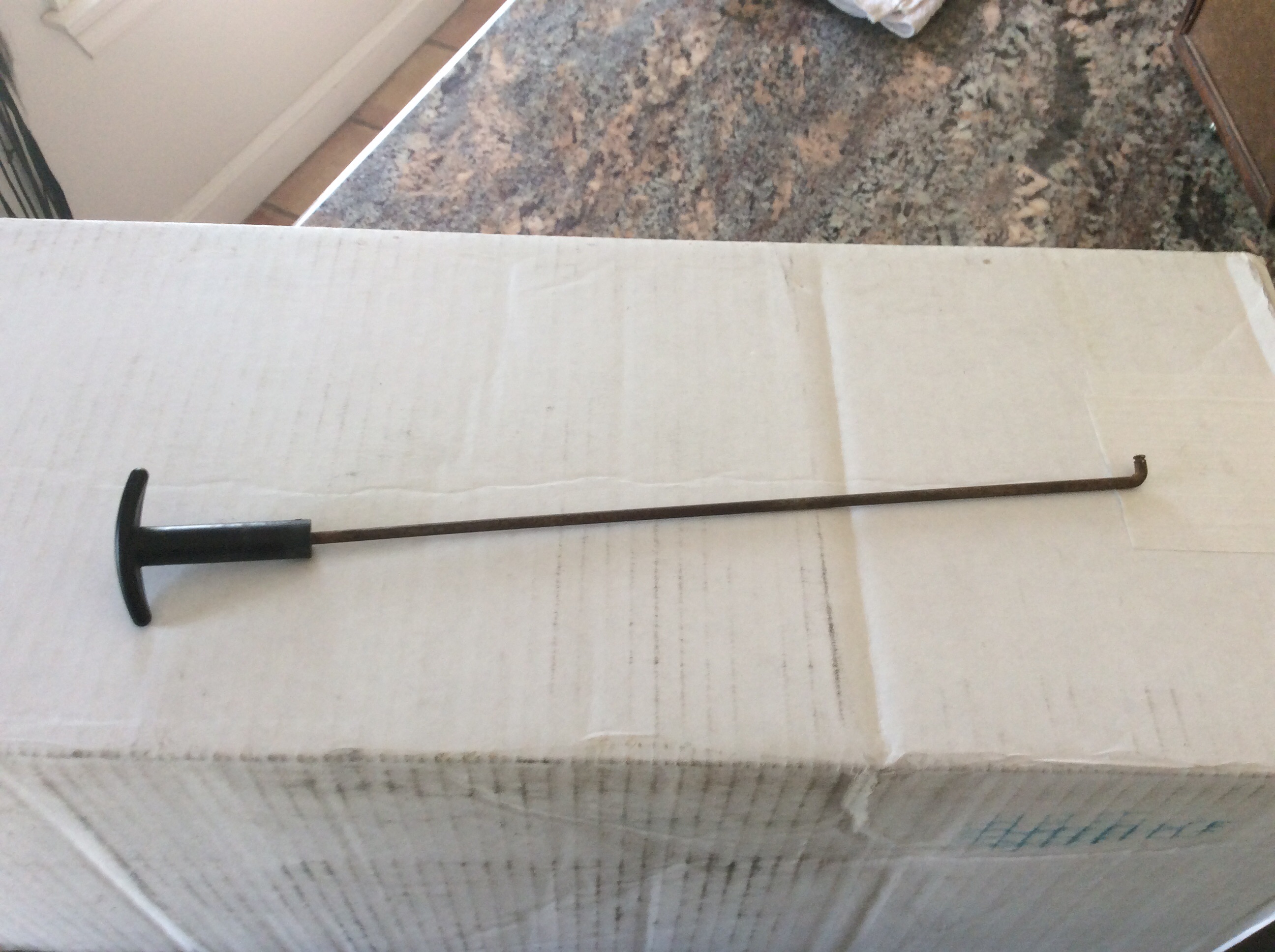

Hey Jim,
Get me your address and I’ll send this one to you.

Wow! Check it out. It isn't anywhere close to the other Oldsmobile models.

Thank you for the consideration. How much do you need to cover shipping and the T-Hood Release?
Jim
Jim
Tuco
Re: First Time Owner of a 1966 Toronado
No worries Jim. No charge. Just PM me your address. Glad to help a brother Toro owner out.
