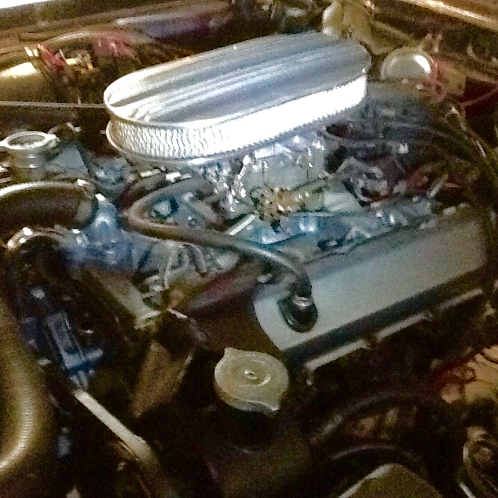

Hello I am fairly new to to TOA. I have.1967 Toronado Deluxe I call La .Sancha. I have been working on her for about two years now. I did the front disc brake convertion and total brake system renovation. Changed out all the fuel system to alcohol proof lines. And gave her a new paint job. I took the original color "Dubennet " added some gold peral and micro flake. It came out fairly well. I am having some wheels made going to 17". Trying to get all ready for Buring up the Beach in Fort Walton Beach, FL next month.

I added the scoop and repainted. I had to redo to cover the hole in the hood for the Edelbrack carb.

Why the Edelbrock instead of a solid rebuild of the Q Jet?

The Quadrojet leaked, I rebuilt it and it still leacked, I sent it off to Chicago for restoration got it back and the performance just was not there. The problem I was told that the car was heat only. And I rebuilt it with factory air. Fuel pump and carb where for heat only set up. (No Feul return) I think that was BS but I was missing some of the carb control parts for AC. Gave up looking for new carb and went to Edelbrock. There is a big difference in performance.

What model is your Edelbrock? Does Edelbrock make a carb that will work and fit under the hood?

I used a 1411 performer series.
No, they measure out that they fit. But then you need to adapt to square bore. And the air cleaner is not like the depressed dual snorkel. No if you want to go Edelbrock or Holley be prepared to modify the hood.
