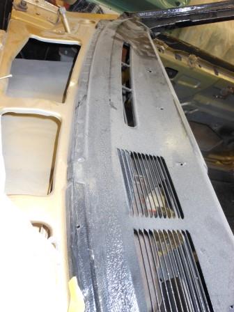

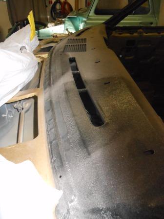

Here's some pictures of the windshield area. Your repair doesn't have the lip for bottom of windshield. Not sure it matters and not sure that really has to be perfectly smooth. In fact, it doesn't as the windshield sealer makes up for the minor gaps. Hope this helps a little. I should have wiped the dust off before I did these pictures. Also, that area is painted glossy, but will be satin. Essentially didn't have to do any repairs of any of this area, thankfully.

Ahhh. None of the other photos have shown the lip and angle at the windshield base.
There was no trace of the lip left on my car. I wonder if the windshield seating area at the bottom has a steep enough angle to allow the windshield to sit flat.
I was using a strait edge from the top lip to the bottom to see the seating angle at the base. So my question is would the windshield would sit flat against that area when installed?

Yes, windshield sits flat against area above the lip. That's where it seats/seals to the body.
