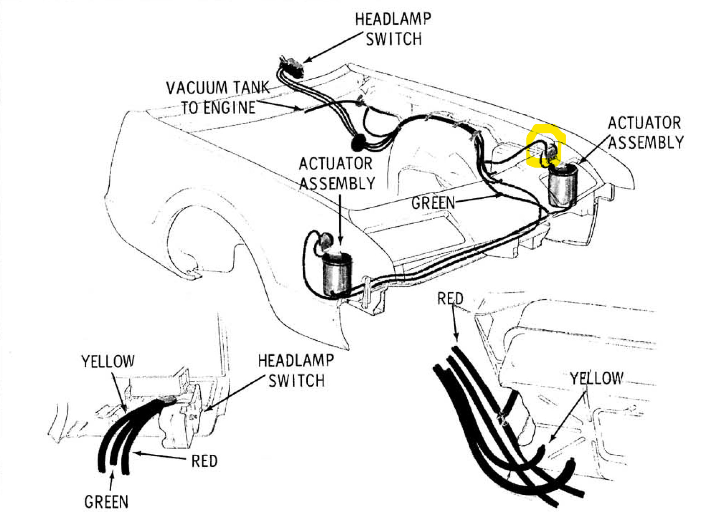

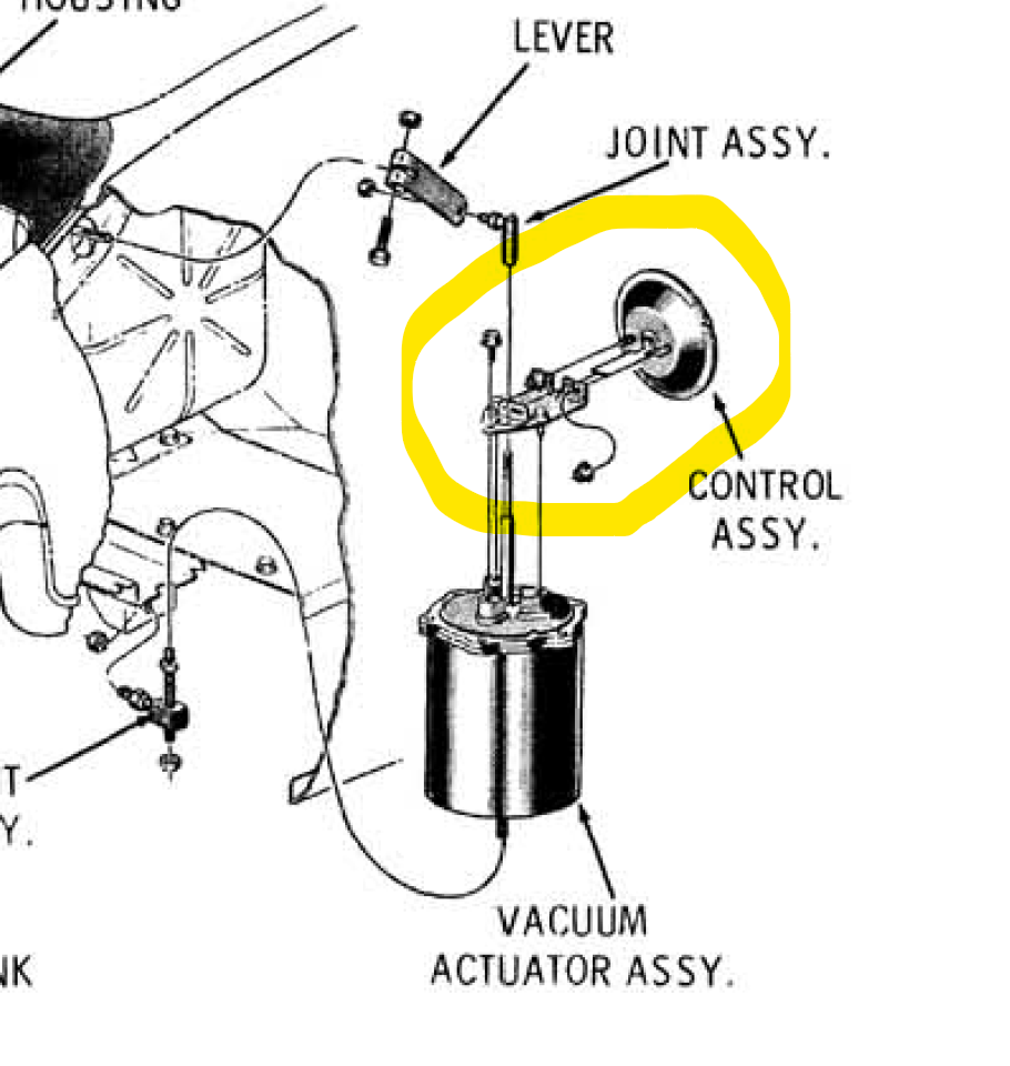

Hi !
Yes, there is three, one is the input, the second, the output for the vacuum actuators and the third is for the control assembly that lock the shaft of the actuators in place and are released to let them going down. I hope my explanation is clear ;)
Check the pictures below. I'm not sure you can do it without the third one.
François.

Francois
Posts: 37
Re: New guy looking at 1966
Postby Francois » Mon Sep 02, 2019 6:44 pm
It seems difficult. I just remember I saw a post regarding this switch : http://www.toronado.org/forum/viewtopic.php?t=1549
I hope it will help :)
Francois
Posts: 37
Postby Francois » Mon Sep 02, 2019 6:48 pm
The problem with a T is that the control actuators will always be working and not go in lock position. It nay not be a problem if the car stand still but when on the road, the bumps and movement of the car may make your headlights to move up and down. You need a system to keep them lock in up position until you switch them off. If you want more info, I can do a diagram.
