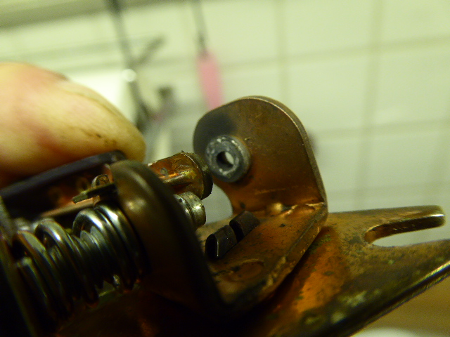

Hi everybody! I´m looking for a good Ignition Distributor for my 1966 Toronado, couse I have a problem with this like at the picture
do you have any recomandations? for that ?? What do you use in your cars ? or what ist the best solution for that ??
thanks for your help!

I suffered those points ignitions when those cars were built. Soon I
was building electronic ignitions for them. Now days, I would just
drop in an HEI from a 77-79 Olds 350, available new or rebuilt. Not
for a 403, has a poor advance curve.
The problem with that car is clearing the air cleaner, might take some
surgery or a 70s air cleaner. Needs the 8mm wires and set plug gap
to about 0.055 in. The ignition ballast resistor must be shorted out,
wire from the starter not needed. Bruce Roe
